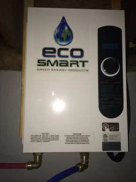

My Neighbor installed a 25-PDV in the basement and saved alot of oil. To eliminate the oil completely, an ECO Smart ECO-18 Hot Water heating system was just installed!
The 40 gallon holding tank takes the 50-60 Deg F town water from the street and warms it to about 70-80 Degrees F, Then using 2 - 40 Amp 220 volt breakers for a maximum of 75 amp draw, instantly heats the water on demand only from the warmer water in the storage tank to the set temp, in their case 120 Degrees for the hot water in the home! I saw the system in action and it seems very efficient. The hot water from the FHW Boiler tankless coil goes right into the ECO tank so the boiler can be used as backup. If the boiler is turned off, the the ECO Smart system will do all the heating.
Does anyone have experience with this system? If a tank of oil or say 250 gallons per year is used to heat hot water for 3.50 per gallon or $875.00 dollars per year then how much would the electricity cost and does it really save money?
The cost of this system is less than $1,000.00 !!!

My ordinary 80 gallon electric hot water heater cost less than $400 and uses $25/mo of electricity.
The same here. And the well water pumped into mine is ice cold. For the life of me I cannot figure out all of the hoops jumped through to heat water.
Not much more efficient then a stand alone old school hot water tank. Electric tank less water heaters can be good if you have limited space but comparing them to an electric tank your not gaining much if anything. Gas tank less heaters are more efficient then a tank because you do not have a stack to lose heat up. If you look up the efficiency of a gas hot water tank they have a EF of about .60 a electric tank can get up to .95.

Too funny, they hope to preheat ice water to room temp by putting a 40 gallon tank in the basement? Even if possible then it would do it by stealing heat from the room which means pellet heat, not "no energy and cost" as you state.
What we have here is a terrible idea. They should have paid 150-200$ for an electric resistance heater wired with a single 30 amp breaker and 10 gauge wire. No fancy circuit boards, no sharkbite fittings, etc.
The savings of heating water on demand vs. storing it hot is almost zero. They use better insulation these days and really, any heat lost from the tank is a savings in pellets to heat the basement.
I would actually be surprised if these systems use less than an ordinary hot water heater.
This 18kw on-demand heater is the same size as the electric boiler I have for backup heating in our house. It rarely gets used but I have seen it overshoot temps if all the demand stops while it is heating. So in this case, when the flow stops there is going to be residual heat left in the system that will dissipate.

There will be little passive gain on the tank 70F water will not be seen you would be lucky to get a couple degrees gain.
You dont get 70F water when you go out for the day come home and turn the faucet on. The well tank gains little in temp.

And that preheat tank will sweat and make a mess on the floor.
For the same money you could buy a HP water heater, much better choice IMO.

That is what I was going to say. Energy is energy and it all goes somewhere. If you're raising the temp of the water from the line at all, it is the air getting colder in the basement...which usually causes condensation and will certainly cool the floor above.
Normal, electric water heaters are a great buy. The only heat lost is the energy that escapes from the tank...and that is pretty minimal. For me, I don't really care...that is all heat that goes into my basement and helps heat it.

I hope this guy has soft water. Otherwise the heater will require regular scale removal.
Also, a system like this can't take advantage of lower off-peak rates like a tank heater could.

Just get a geospring, you'll save more energy and get a rebate check. If you are running a boiler all summer, switching to the HPWH is like printing money.

I'd be a little worried about Legionella pneumophila or anaerobic bacteria growing in a tank under 130ºF
70ºF may be too cold for Legionella but not for anaerobic. Anaerobic supposedly won't harm you it just stinks.
