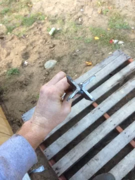

I took 2 4'' pieces of 1.25'' angle iron welded back to back, with a nut welded to the top of that, which should come out to approx. 1.875'' OD. Its not perfectly straight so it wobbles a little and worked perfect getting scale and creosote off turbulator tubes

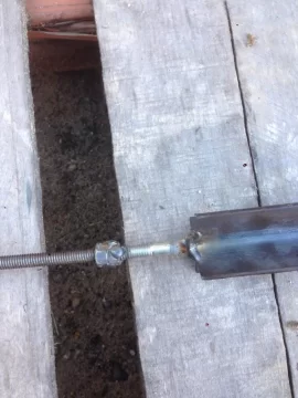

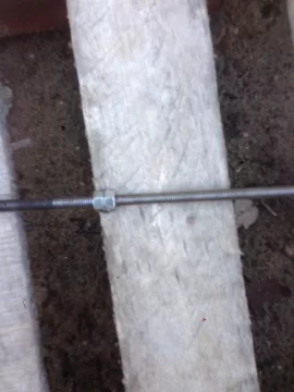

A couple sections of threaded rod with nuts welded back to back to act as couplings made the little tool reach all the way down, as roof space is an issue for me
Just hook this bad boy up to a drill and start off with a low speed and torque setting so you don't get into any trouble to start out

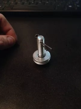

And putting things back together, instead of having nuts threaded on rusty bolts and fighting with wrenches, I drilled a 7/64 hole in the end of two bolts, used a couple washers and a cotter pin to make removal much easier next time.
