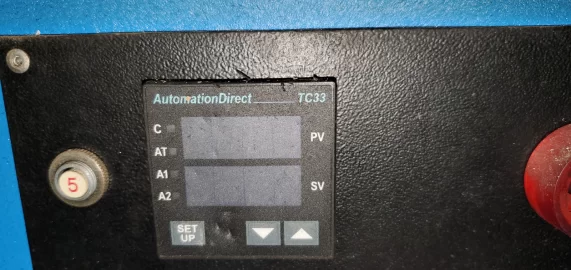

It's been a long time since I posted but I ran into an issue with my econoburn ebw 150 recently. It appears that the automation direct tc33 is shorting out. My question is since the tc33 is discontinued has anyone changed one out with a automation direct solo?
Hi ,Econoburn user here a 200 model
I don't recognize the parts you are mentioning, could you post pictures?
Thanks
Thanks for the reply, I have an older unit from around 2009. They have since switched the controller. I've attached a picture of the one I have.

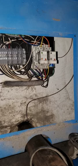

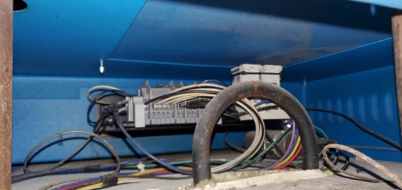

Just in case anyone else has this issue, I had a battery backup unit sitting on top of the wood boiler which caused the top to sag just enough to touch the manual buttons on the two relays. I think it was barely touching them and they were half tripping. I'll try to post some pictures to show the issue. I was able to slightly bend the metal shelf that holds the electronic components down a bit and I moved the battery backup unit. Everything seems to be working correctly again.
Reactions: brenndatomu
Here are some pictures after I bent the shelf down a bit. Then another one through the access panel on the top.

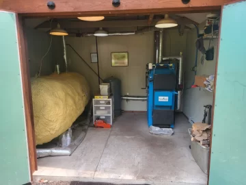

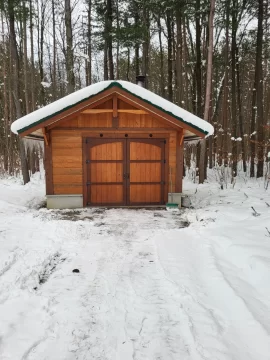

I'll join the Econoburn party, started in 2009 with my 100 in the basement(no storage then) and did that for 4 years. There were pros and cons to that location and the cons were more than the pros so I bit the bullet in 2014 and moved it to the shed pictured here with 500 gals of storage. As Salecker says this was a game changer. This is how a gasifier shines and is made to operate. Basically a 4 hour full blast never idle burn daily is sufficient for house and DHW loads. Today is an exception caus its 6 dg F this mornin in Western NY , so I will do two smaller burns AM and PM. The advantages to storage in my case are convenience on burns and less boiler cleaning due to the full blast , no idle burns. I do one mid season heat exchanger tube cleaning with a special tool (brushes won't get you back to bare metal tubes) and again end of season. 10 to 12 face cords a year of any kind of wood both hard and soft . whtever is dead on my land I cut and burn. Its been a good run with the econoburn and I never regret my all in decision to heat with wood especially with the escalation of heating costs , the oil, gas , propane costs will never go down but mine are predictable and don't change . my monthly bill is sweat equity.
