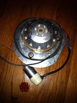

Yes the Ecoteck blower speed programmed parameters are in RPM. Also the actual motor RPM is displayed at the top of the "State Stove" screen. I bet they both use the same EBM Pabst combustion motor/fan part number. I am pretty sure the Rika Austroflamm stoves use the same motor too.
Interesting. Looking at my programming manual on the back page they list all the electronic motors and components. There is a description for the combustion fan:
R2E150-AN89-11 6PALE v115
Just ran a search, and it looks like you're right, it's some model of Papst fan, around $200.
Image of EBM Pabst combustion motor.
Thanks, I think it's immensely useful to know that many of these European-made stoves use similar parts. Not that I need any parts right now, but it never hurts to be prepared for problems by following threads for Ecotecks and Astroflamms and probably Palazettis as well.
that looks a lot like my exhaust blower too
Pelleting in NJ has an Ecoteck Elena Steel. I'm thinking all the Ecotecks may use the same combustion blower.
