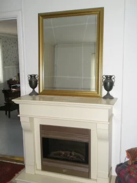

This is a picture of the chimney wall (there now stands a electrical fireplace in front of it) and this is the spot where I want to install the fireplace.
I cannot show the pipe/canal that I want to tap into because it is in the chimney wall.

The electric stove will need to be removed in order to see what exists above it. If there is a flue and it is open, then a stainless liner may be able to be put in the existing flue with a tee at the proper height and a stub that continues down to the fireplace opening with a cap. .This will be used for cleaning the liner. There are strict clearance rules for the thimble passing through a wall if there are any combustibles in the wall. Have you brought in a professional installer for an inspection and estimate?

The electric stove is a stand alone decorative piece that is purely electrical and does not have any connection to the chimney.
The chimney wall behind it does not have any openings and consists of a stone wall without any combustible materials.
