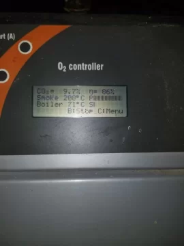

This is an image of the screen after 2hrs of burn. I started this fire at 9am.
Co2= is at 7%

Another current image of the screen.
A current image of the burn.
  • [Hearth.com] Effecta lambda 35
What happens after 2 hours? I guess I assumed that once the secondary starts to adjust your co2 works its way to 13% and you start running 50/50 primary/secondary.
John, if you notice in the newest picture the secondary door has opened one notch. I have the boiler set to 10% currently to try to get the secondary to adjust. It will barely reach 10%. Usually it reaches 12% plus right after the boiler reaches 100*c, and then the secondary kicks in.
