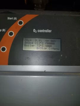

If the thermocouple in the boiler flue is above 100c/ 212f the electronics should work allowing you to leave the existing o2 sensor in the flue, plug the old one into the harness hold it with a pair of Chanel locks and put the lot propane torch to it for 10 sec. it should drive the co2 to its high limit on the display and you should be able with the door open or front cover off to watch if you get primary baffle to close or do anything.

Tc, this is a pic and video of the damper doors. They are running about 70%p 30%s right now. I have had a continuous fire since 11ish am this morning.
The dampers are adjusting as they should.

John, is there a way to manually calibrate the stove? Or at least just let it stay at 70/30?
I have another question. Wouldn't wetter the wood produce higher amounts of co2?
There is the test function mode where you can manually calibrate but I don't know if they stay there or if the computer then resets them.
