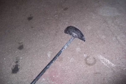

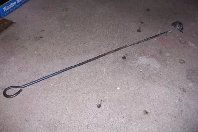

I use a small hoe ground to the radius of the U blocks and drag the ashes forward so they spill on to the floor of the lower chamber and then turn it over to the flat side and rake left and right of the blocks. I then rake them into a sieve box with 1/8 inch hardware mesh on the bottom that is setting on an oversized flat cake pan. Only the fines go through greatly reducing the amount of waste ash that needs to be disposed of. If she burns full time she probably won't get as much charcoal in the lower chamber as I do but I start a cold fire every day and while raking charcoal over the nozzle much falls through.
The cake pan could be engineered much like the ash pan on many of the Vermont Castings stoves with a sliding cover with a handle or you could drag your feet as I have and leave it in it's
original form and carry it out to the ash can.

That looks like the tool that came with my Wood Gun.
Did you salvage that from your "$10k pile of scrap"?
Actually, yes. the radius had to be ground to match the U blocks. Best thing Wood Gun ever made;)
