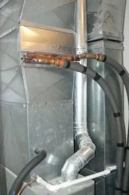

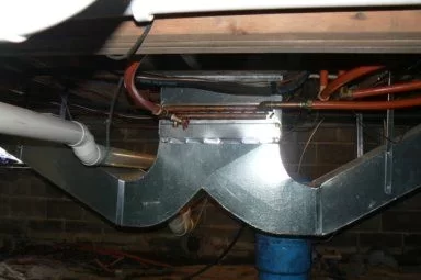

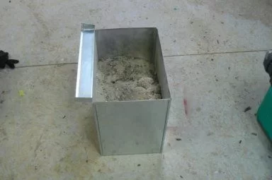

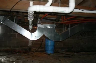

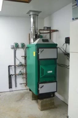

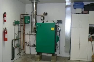

Hope thes pictures come out, I included pictures of my ductwork modification for the heat exchangers, boiler installation and my homemade ash can. The can works great especially with the boiler being 18" off floor, I filled this can twice all season-Nov.-March. I have a little shorter burning season than most of you, with me being in southeast MI.

Beautiful setup. Thanks for sharing. Really nice.
I get a lot more ash than that. How much wood do you burn?
My only comment would be that I would have gone with black stovepipe up to the ceiling 1.) to save money on the chimney and cleanout tee; and 2.) to recover some radiant heat for the boiler room instead of sending it up the chimney.

I probably burned 4 cords if I had to guess, Zennon recommended using double wsll being in the garage to reduce condensation off the pipe, it sure would have been cheaper!!! I also check the clean out about every three weeks, always find ash dust in it. Thanks for the compliment on the system, a few hours involved as I"m sure you know.

I'm thinking the only reason for bringing the chimney down to the stove would be if condensation is a concern, but I don't claim any knowledge or expertise beyond my own limited experience.
I think when Zennon told me this, He probably didn"tknow that the garage was insulated. Really not a bad decision though, cause the garage still will stay at 55-65 degrees depending on out door temp and nice protection from getting burned. Just learning how this posting works. But really like this site-it"s very addicting.
Well, time is one thing, but having the skill and vision to set everything up so neat and well organized is pretty impressive. I especially like the fire extinguisher mounting. Did you do the work yourself? Why did you put the boiler up on blocks?

Code in Michigan which(for furnaces or water heaters) in garages is 18" for burners off floor. Just a little precaution when I set it up. Makes it alot easier to clean ashes out. I did do all my self with help from a friend or two. I"ve been in the hvac and boiler trade for about 12 years. And yes the wife also loves the warmer house. I store my wood in the garage so it always stays nice and dry, Can go out in the morning in slippers and underware and reload which is nice. Getting back to the ashes, I found the longer it burns (less ideling) the less ashes youhave. Also, Dave at Cozy Heat helped me alot with piping diagram, pipe size, etc. He was very helpful. I can"t take all the credit.
eekster!!! I am not in to art in any way shape or form,but I can honestly say you have swayed me with your pics and setup . Very nice and congrats on your finsished project !!!

I think I am at about the same place as Tony H with regards to my planning for the EKO 40. I too would be interested in viewing any diagrams you may have that show how you have designed yours. The more detail the better. I have looked closely at the pictures you posted. I wish the resolution was better so I could see things more clearly. What is the black box the that is located near the output of the EKO? I am guessing that it is a low water cut off. Close????

Thanks eekster I am most interested in the plumbing right near the boiler with detail or labels so I can make out what is what.

I have that much ash a week! I idle allot though with my 60. Just to be sure im on the right page, idling would mean when the boiler shuts its fans down when up to temp. AKA going into idle.
Ya that setup is very artistic. And how the heck do you keep that room white? You must have terrific draft and no inside smoke.
I get about 4 or 5 gallons a week, on average.

Last, to Barnartist I have about 18 feet of chminey, so it does draft well it is 8" diameter also. The old 10 foot rule doesn"t always apply especially with wood. I tried to cheat and lost. Had to add another 5 feet to the stack to clear 2nd floor roof. Had bad backdraft with northwest wind. With my ash, I really don"t have as much as you guys, I don"t live in that cold of area( right now it is 38 out and raining) I clean my box every 3-4 days and maybe have a gallon or so of ash. I also do not clean out the burning chamber till the end of the season, which would also add a fair amount of ash. I was wondering do you other EKO users clean out your tee? As I said before I get about a quart of ash in it a month, I think its just from the motor and how light the ash is. Hope this wasn"t too long of a post, but I always can"t back in a timely fashion. Thanks for all the interest.
