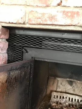

Hi, I’m new to this forum. We recently bought a house that has an “El Fuego” fireplace from 1976. The company is now Fuego Flame, but I need to know if anyone on here has replaced theirs? Has anyone put a wood stove in it or in front of it with the existing flue and insulated liner? Any advice or suggestions would be appreciated. I had one guy come out and look at it. He said he would have to rip out my brick surround, tear out the fireplace and replace that plus replace the insulated liner that’s in it. I would then have to hire a mason in addition to that to build a new surround or redo the brick. It’s costly, and I really don’t want to touch the brick.
Without knowing the firebox size it's tough to tell what options are available to your. It's probably a "slammer" install, so just ripping the thing out is probably the easiest thing to do, and then go with an insert or freestanding stove. Pictures would be very helpful.

Thank you, Sodbuster! Here are some pictures!

It sure looks to me like it could be taken out without messing with your brick. If it's a masonry chimney your in luck. Looks like an insert would slide in that fireplace easily, and would be a real heater. What is the width and the height of the opening?

It is an insert. Separate from the masonry around it. Just take apart the front parts, get it free from the flue, and slide the metal box out. Install a quality insert, and you will be glad you did, and get much more heat out of a newer insert. You should not have to mess with the brick at all.
