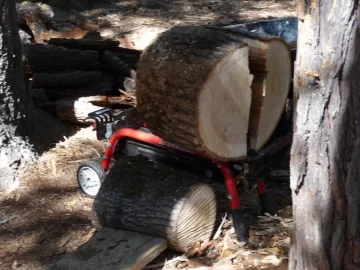

Still using and loving my 5 ton Homelite (also sold as Ryobi and numerous other brands).
http://www.homedepot.com/p/Homelite-5-Ton-Electric-Log-Splitter-UT49103/202019865
By no means is it limited to small stuff. I've split 28 in. diameter oak
[Hearth.com] Electric Splitter Recommendations
and Doug fir up to 33 in., routinely splitting stuff in the 18 to 20 in. range. I share it with a friend, we each burn about 5 cords/year, in our 5th year now.
The model sold at HF is a two-speed rated at 7-tons. The details of the motor and cylinder show that it is the same basic unit as the others.
At $300 from Home-Depot (potentially less from others), I cannot say enough good about these units. I will buy another when (if) this one finally quits.
