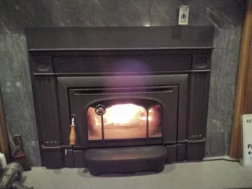

Picture of sheet metal for a HI200, actually U shape.

So you didn't need any additional coverage in the sides either, just on top. Did you buy a custom surround? Does this stick out to the left or right of your trim? Or are the sides completely behind the cast iron and only the top is visible?
It extends about 1 inch on each side but that is just for looks. The surround is the standard one that came with the insert. The sheet metal is just held in place by the surround. When I had my insert installed I was all ready with bricks to raise the bottom. The installers said I'll just get a sheet of metal cut and be back next week. They didn't charge anything extra. Raising the bottom would have left the blower hanging.
Reactions: begreen

It trimmed out nicely. Thanks for sharing.

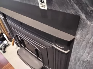

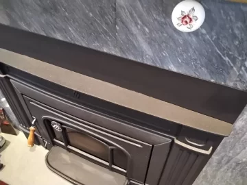

More pictures.

Simple is good. I would suggest putting a small 1/4 radius on the upper corners.
