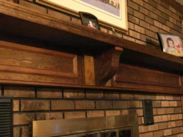

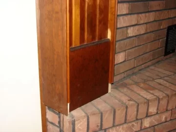

About the pictures, the existing facing was at 37 inches from the hearth. After much consternation and reading about mantle shields, I decided to the easiest thing to do in my situation would be to cut off 2" of trim to get to the minimum 39" That left a 2" gap at the bottom. A couple of more pics will show the bottom result.

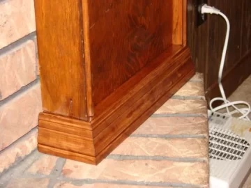

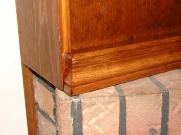

Here's the finished bottom. The casing matches the top of the mantle including the return detail around the end.
Is it Friday yet?
