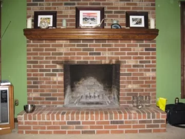

Price is not the issue. I really like the face & surround detail on the Hampton. I also considered the Quadra-Fire 4100i (also a very nice looking insert) and the VC winterwarm Lg, but after reading every review I could find on them I decided Hampton sounded like a better all around choice for my application. Now it's time to narrow down the color choice's. The insert will be the focal point of my lg (22x22) living room. Visualizing the unit in place is difficult and I am relying on pic's of others stoves to give me a better idea of what the finished project will look like. Here is the hearth is will be filling.

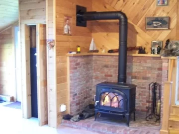

Going on my second season with a jotul oslo. BTW, you can get a black enamel for the traditional look. It replaced and old franklin which was painted and repainted several times. With the rough finish it would be impossible to clean with anything. With the enamel I just use a swiffer or feather duster, when the stove is not hot of course.
Re visualizing the insert in place, check out this post. I'm not sure what software was used, maybe you PM the poster and ask.
https://www.hearth.com/talk/threads/9202/
PS - That hampton is real nice looking. What's markup for the enamel? The timberline brown might coordinate nicely with the mantle.

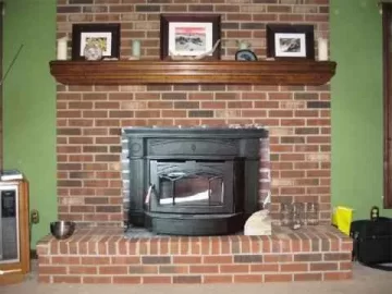

Here is a very rough cut and paste job.

Brotherbart, thanks for the cut and paste. I also tried that with all the diffrent colors and it seemed to help. Seeing the same stove in multipul applications definitely helps, so I am hoping more Hampton owners will offer up pics of thier home and hearths.
