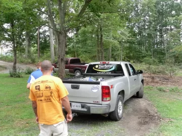

Well I already miss my little green stove,
And these are the folks that were very nice and worked with me on this The Stop Winchester Va.

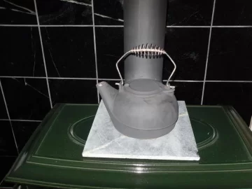

nice stove pic Capt. Ive never seen a wood stove installed in a walk in shower before! ;-P
