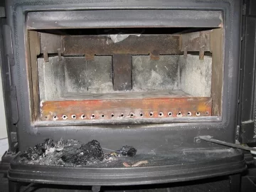

We've gone through about 1.5 cord of wood so far. Time for a stove shutdown and inspection. It's been burning hot lately. I thought it was the wood because we had some very dry fir in the first cord, but now we are burning fir that has been seasoned 9 months and it was burning a bit too eagerly so time for an inspection.

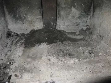

I shoveled out the ash and then took out the vacuum to clean up. As I vacuumed the inside of the stove door the entire bottom run of the gasket dropped out of the groove. Hmmm, that may be the issue. I glued it back in place and let it set up for a couple hours. Cleaning with the sooteater went fine. The baffle is in great shape. Only got a couple cups of fine sote. I see that I have cracked my first brick in the back and know when it happened last week. Don't shove in splits so hard that they hit the bricks!
The stove is ready for the rest of the season. After 8 seasons the only expenses have been the door and secondary tube gaskets. Not bad. The gasket appears to have been the issue. Last night's 11am loading was just a few thick splits. There was a nice hot coal bed this morning at 8am. The kaowool on the sides of the baffle is starting to look ratty. I will replace that next summer. May replace the door latch then too as it is getting sloppy.

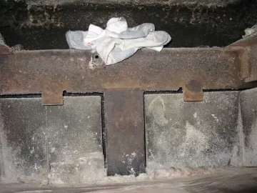

sock stuffed in secondary tube

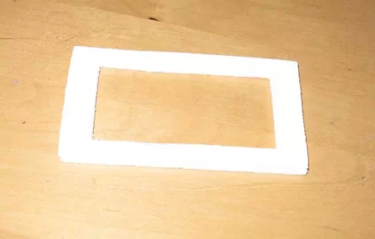

new gaskets (doubled)

couple cups of soot and sote are what came out of the flue

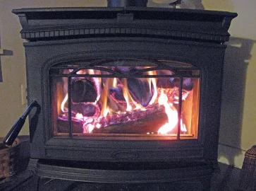

burning nicely again.

Great information Begreen. I have a feeling that my door gasket on my T5 is not performing as well as it should. It seems to have come away from the door in several spots, it is flat and hard. I believe the gasket size is 5/16" and I noticed that the existing gasket has some type of covering over the joint. I am I best to order a replacement from PE to do this job? So can you tell me the proper method of replacing this gasket? Do you simply lay it into the track or do you stretch it all? What is the recommended adhesive for this gasket.
Any suggestions would be appreciated. The stove is in its fourth year of use. What kind of like are others getting from this part?
Yes, the graphite impregnated gasket is 5/16". Don't stretch it. Rutland's gasket should be ok. Remove the old gasket and clean the channel very well for a good bond with the new gasket. I used Meeco gasket black adhesive but will probably use black RTV the next time. If you use the Rutland or Meeco gasket adhesive be sure to mix it very well in the tube first by kneading it a lot.

Update 1/3/2017: Well the Meeco failed after a season of use. The gasket just dropped out of the channel in spite of a good bead of cement still adhered to the back of the gasket. Switched to Rutland for replacement today. It's a much more homogenous mix, not watery. I also got some better high-density 5/16 gasket from the local dealer. It was bronzed and I suspect this might be Meeco brand but am not sure. Definitely more dense than the gasket I put on last season.
