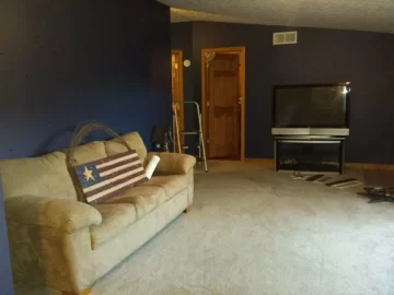

    Room is painted, stove is in place, and hole in wall is cut. Ran into a few small problems, so it should be done tomorrow.
    The color is a little "bright", but me and the Wife like it. My kitchen area is Red (living room area also), the dining room is Off white (pic show everything piled in thre/room where Quad used to be), and this room finishes off the Americana theme. Red, White, and Blue.... And a Canadian stove ;) Just kidding. This thing is the cats meow.
    Will post pics of control board later. All touch screen. :) Love it!! :cool:
    Never had a stove in a room with a TV. My living room has the 65" Sharp Aqous, and the old 50" Vizio is now in my new Pellet stove room. :) Couldn't be happier.

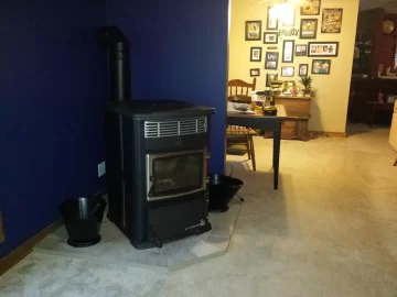

    Finishing the vent today hopefully. .
    As for the pad, its a different pad. I had a 42" corner pad for the Quad and used the minimum clearance when I installed it (2" from corner of stove to the side of the wall). Wanted it tucked back and clean because it was direct vented. The Main problem with that was, there was NO room to work in the stove. I had to break the seal to remove the convection blower... Not fun.
    So this other pad (got it with the purchase of a Castile) is a 48" corner pad and I have gone the opposite route with this install. I have enough room to walk behind the stove and do maintenance. I used the minimum clearance from front of stove to front of pad (6"). It sticks out farther, but once finished, I will be much happier with this set up. The Enerzone is also installed one room over from where the Quad was. Quad was in the dining room (beige colored room, with lots of pics on the wall).
    This now gives the Wife and I our own room. The kids have the Living room (open to the kitchen/one big room) and the big TV and PS3 and we have the Family room w/ smaller TV and a pretty stove :)

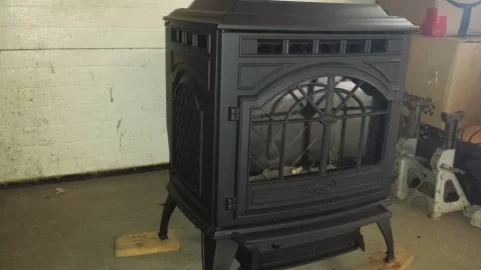

    (Pic of Castile I bought and refurbished)

    Already sold :) Never intended to keep it. Bought the stove and got the pad for free. Kept the pad and made a few bucks on the stove

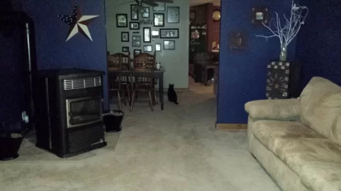

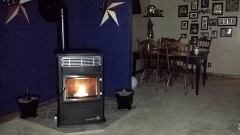

    Exhaust is hooked up and it was running for a bit. Just below 50* right now. It ran on pilot for 30 min (can be adjusted for pilot time, based on your likings? 30 min? 45 min? 60 min? Etc...
    I must say, I am in love. This thing is the cats meow. In my garage it did pretty good for break in fires, but in the house? Holy Chit!!!
    Looking forward to the cold. . Bring it on Old Man Winter!!

    Shock and awe followed by a moment of silence. Even the hods are poised at attention. Great looking setup.
