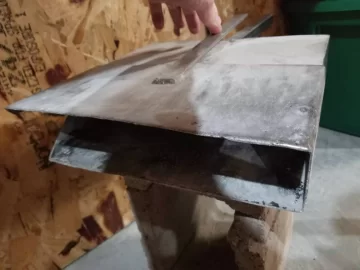

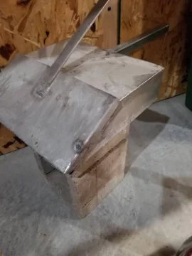

I made one of these for the ash, they are also available online. Mine is stainless steel should last forever. No mess, no dust but it does get warm if the ash has some coals. Try to open the air all the way at the end of the burn and rake coals forward.

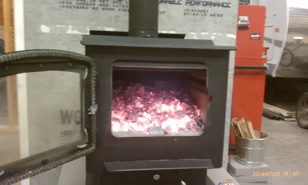

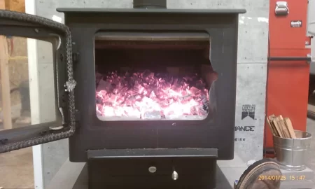

You can really coal up an nc30 if you're burning it hard. Even with softwoods!
That's some serious coaling alright. Throwing any heat? I would think so but maybe not enough in a barn.
Sure it’s too hot to touch and perfect for cooking but much cooler than when she’s rocking with fresh fuel. Open door for some nice radiant heat.
This is the struggle for anyone with an undersized wood burner. The nc30 is undersized for my application but it’s also about the biggest stove out there so we make the best of it.
