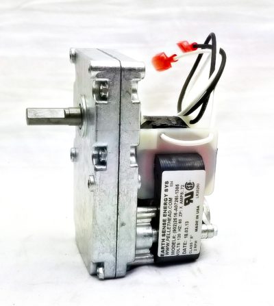

Purchased a used 25-pdv and it worked amazingly for about a week (80°-88° on my main floor/ about 70° upstairs). Top auger died and service couldn't be scheduled until February. (This, for now, is my main source of heat until gas boiler can be replaced.) Did my research and replaced auger myself, which surprisingly, wasn't hard at all. Ran good for one day and convection blower died. Did more research and replaced that myself too (now THAT was a pain in the ass to do).

Is the flame size the same as before when heat was great ??
Is the RPM for the auger motor the same as the one you replaced ?
Random thoughts: Are you running this on a thermostat? Are your heat / blower settings where you had them previously?
I'm assuming you removed power (unplugged) when you changed these motors out. Did the stove change programming mode? Should be mode 'C' I believe.
