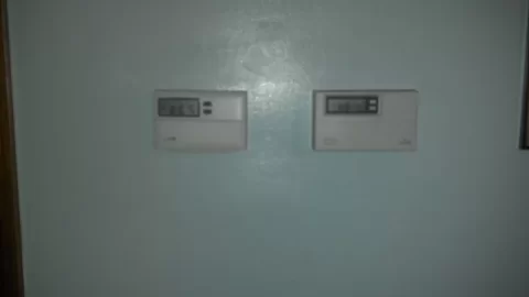

    ARE YOU GUYS READY FOR THIS???
    Feel free to use this post however you want,,,, like "Stupidest problems we ever tried to solve on the forum",,,,,or something like that,,,,
    I went through all of the diagnostics suggested above over the last 3 hours, ending with checking continuity of the stat wires at the board, had none, pulled stat off of wall to check continuity of contacts, it was working fine,,,,,,,AHA!! I said, broken wire!!!
    As I was putting the t-stat back together i saw there were 3 wires hooked to it,,,,hmmm should only be 2,,,,,now you need to look at the pic below.....
    Right t-stat is for my gas furnace (3 wire system),,,, left one is for pellet stove (2 wire).....
    you guessed it.
    I WAS USING THE WRONG STAT TO CONTROL THE PELLET STOVE!!!!
    I feel so ashamed,,,,,,,,,,,,,,but thanks to all you guys,, reallly,,,, thanks,
