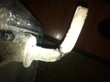

I have searched all over for information on this topic, but yet find anything. The door latch(inside door handle) is almost ready to break off on my year 2000 Englander 25 pvdc. Not sure if this is a replaceable part or I need to replace the whole door. Irritating. any help would be much appreciated. I emailed and called Englander, with no reply...(btw...Englander needs to dump the Indian based support....terrible....)

The door to the stove lifts off. Find a local metal smith / welder and have it repaired (welded).
