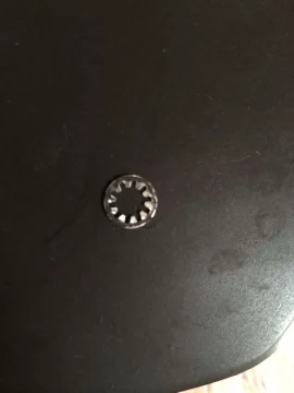

Since turning to the left loosens a bolt on threads, the Left Latch on some Englander stoves keeps getting loose?
Has anyone seen this problem? What did you do to fix it?
Here is what I am trying on this one stove where just the left latch just keeps getting loose!
The star lock washer inn this case seems to have lost it's grip. (Pic 1)

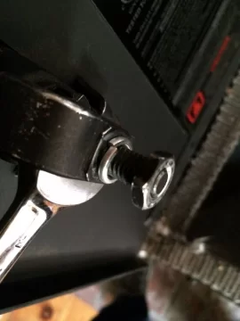

Therefore I put in a very beefy C lock washer (Pic 2) so we will see what happens this year under normal use!

I will let you know how the heavier split lock washer works. I do like it better than the OEM
