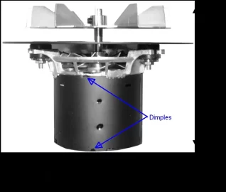

I had the same symptom with the pdvc that I rebuilt. The culprit was the bearing carriers on the motor. The bearings on mine are mounted to the end plates of the motor, and the end plates are each held in place by dimples in the motor sleeve. All I needed to do is use a nail-set and hammer to tighten the dimples on the end plates. There is still some vibration, but the rattle is gone.
what are end plates and where are they
The motor is a cylinder with an external metal sleeve and two metal disks at the ends of the cylinder. The bearings are at the centers of those disks, Those disks are the end plates. The photo below shows the location of the dimples. There are several spaced around the circumference.

Motor rattle is caused by something moving colliding with something stationary. Sometimes it is caused by a rotor far enough off center that the vibration results in surrounding objects collide. More often the rotor gets far enough off center to collide with the stator. If you were to disassemble the motor and look at the rotor you would see scuff marks on it's circumference. In both cases it is more than oil can cure. Either the bearings (bushings) are worn beyond service or their carrier plate is loose.
