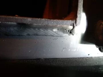

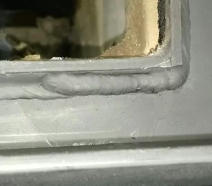

Thought I would show a couple pics of the fix. So far it's held great and looks good. I also added a couple cut fire bricks to shield the bottom door weld and corners. So far the stove has been twice as good as last year with the changes I've made this yr (dry wood and more efficient ducting). Thx for all the help.
