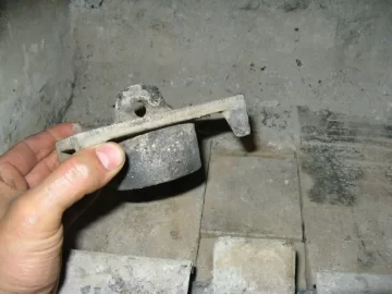

Looks like the extra firebrick I had was probably the only non-dimensional one of the bunch. It was just over an 1/8 inch too long to replace one short piece and about 1 inch too short to go it on its own. Tried pushing the one in the back further back but it was already home. Rather than switch the blade on the circ saw or try and knock just that little bit off, I just took the rock chisel and broke this firebrick to size and kept both factory short pieces. I put some furnace cement around the hole to seal the firebrick just to assuage my OCD a bit even though a plain firebrick just set there would probably seal better than that plug anyway after examining it.
Since I have said "pics or it didn't happen" on here probably 200 times, I figure I had better put one up.
Anyone w/ a 30 out here actually use this plug regularly for an extended period of time?
Thanks for the advice folks,
Nope. and mine will be on the shelf in the garage next to the doghouse by sundown tomorrow. The hump sits right where I like to put the Super Cedar.
