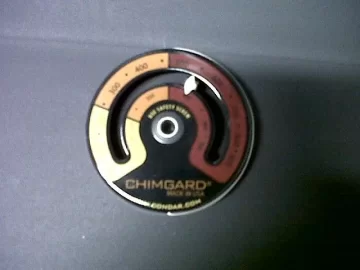

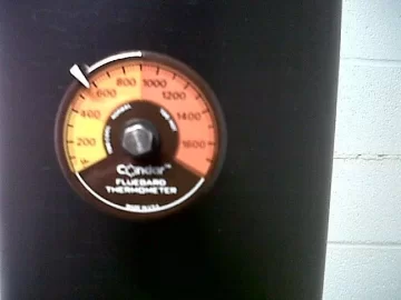

If anybody has not noticed, I like to Post Pics (Pics of the Wood Piles, Pellet stove, Wood stove, etc).. A Full Review will come this Winter. I cant wait. I am eternally grateful to Forum member lethaldose. He gave me the deal of a lifetime. Me and my Family are forever in debt to hime. Oh yeah, I forgot to mention the wood he gave me too. I almost got a half cord stuffed in the truck when we brought it home.
If this stove heated that well (Got to about 570* stove top/I know these are inacruate, but its an indicator) and had good secondaries (On 2 month Silver Maple). I was completely shocked. Im gonna go out today and split a few of the Silvers from 2 monmths back and check the M/C. Silver Maple from the begining of May is in the Woodshed and the biggest splits are already below 20%.

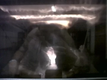

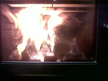

Well its the 2nd night with a Fire. Tonight is the last night until season starts.

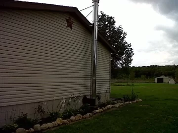

i installed the Extended roof Brackets today. Although I am only 4 ft above were Pipe is above roof line and 2 3/4' above the Peak (Well over the 2 ft). I may add the 3 ft section I did not install. It drafts great at 70 and tonight its 56 and doing a little better.
The one question I have now, is how fat do you shut down you air and do you shut it all the way (This depends on a lot of variables), but I am looking for general answers.
Thanks for everyone that helped. Its in a portion of my 2,180 sq ft basement (Upstairs is 2,180 also) that is closed of to about 800 sq. It got well over 80* really quick tonight. It was about 60 inside when I started the Fire.
gonna be a Good Winter.

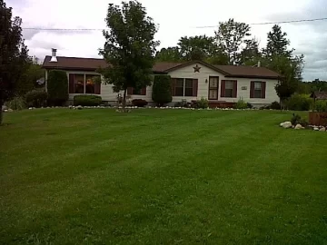

  • [Hearth.com] Englander 30-NC / (Installed w/Pics and FIRE!!!) Completed!

Congrats and Looking good!
Your in great shape for Winter ...... :-)
Once the fires crusin, I push the rod in until the spring on the end is flush with shelf above it. This seems to give me the best heat, and longest burn time. Great job on the install ! All that shiney chimney pipe makes me smile :) Won't be long now !

The stove is drawing really good. It was 71 the night I installed and had great draft and fantastic secondaries. Was about 56 Last night and did a little better (Could have been the wood. Used Pine last night ... Ahhhh > NO, NOT PINE!!! LOL, mixed with some ash and silver maple)
So my thought is, it couldnt hurt to have one. if it needs left wide open? Then so be it. But would be a nice feature. IMO. I think the kit was $17 from the local store. Rod is long enough to go through my Pipe. Just need to drill a hole?? I think?
Anyone ever use a kit instead of the adapter that comes with the damper?

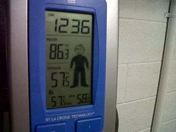

Thanks again everybody. I am hooked. Had the basement to about 90 last night. Still got a lot to learn about when to shut down the air and what the fire should look like when I do so. The glass was clean this morning and at 10 a.m. there was a good bed of coals. I threw the last 2 splits in at 1:30 a.m. and settled in for the night. I can see myself spending a lot of time downstairs now... A Lot!!

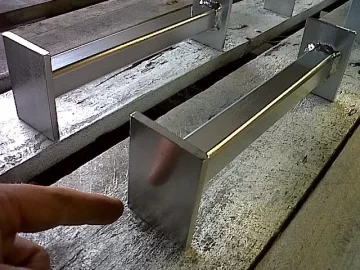

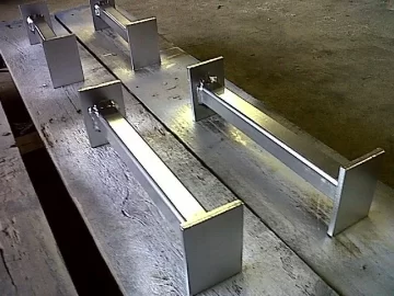

Well....... Its a couple days later than expected. But the Millright at work got my Brackets done. I needed 10" extensions to afix my brackets to my house, because I didnt cut out my overhang/eve..
He gave them to me today (Yes, I had to work today/ All Double time/10 hrs). I got home and painted them, but I have to work 12 hrs (3 a.m. to 3 p.m) tomorrow. So I will hopefully hang them this week. I painted them an Aluminium/Stainless/Chrome color. After 4 coats, they were pretty shiny. In the one pic, you can see the reflection of my finger.. Still need to drill the holes. But that will come when I get time.
The distance between the Thimble and the Bracket that is mounted to the side of the house (Overhang/Eve) is about 11 ft. 2 brackets should be plenty with one every 3.5 ft. Total of 15 ft of Class A. I installed the extended roof bracket also. In case I end up needing the last 3' section of Class A I didnt use.
Thanks for every ones help...
