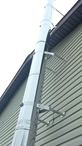

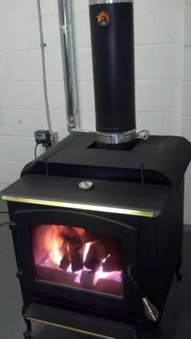

Well, to finalize.. I forgot to add pics of the Brackets attched to the house. I did end up adding the last 3 ft section of Flue, Even though it is not that cold. I did notice a difference in the Draft. I have to close the Primary down further than usual. To the point where it is almost closed. If open more than 3/4"-1", its starts to skyrocket to 700* and beyond.
There is a bracket every 4 ft (Actually about 3' 10") and the added support brackets for the upper section. Seeing how it is about 6-6.5 ft above roof line.
They are simple brackets. Made out of 1" x 1" square stock, with 2" x 3" flat stock (1/4") welded on the ends. Solid as a Rock now.
Hope this helps someone with there install down the road. It did take a little extra thinking (Most done on Forum members part) but it eliminated me cutting out the eve/overhang.

Enjoy your 30. Nice job. Nice clean install on the outside chimney.

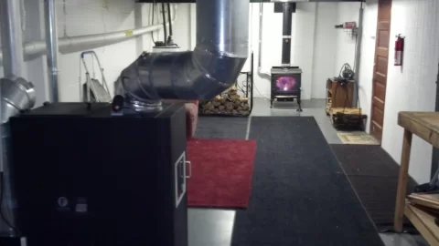

Actually the Man Cave is on the other side pf the basement (finished) complete with 12' bar, pool table, foose ball table, card table, dart board, TV, stereo, etc... I plan on finishing this last piece of the basement this Winter. I may bring all that into this room and turn the Now Man Cave into a bigger Pellet Crib. 7 ton is all I can fit into my current room. 2 ton sit outside the room.
Thanks for the replies everyone. The 30 is a great stove... I look forward to the many threads ahead from all of us new users....
Well, it's been 2 full seasons of use and nothing but good things to say. The 30-NC is one heck of a steel stove.
The stove is ever evolving. I have since swapped the Ped for the Legs and I am currently painting it Honey Glo Brown (Stove Bright paint). Also added the blower (the 1st season was without blower, went full 2nd season with) and also added a convection deck (Mod!!!. i also used it 1st season with No OAK and 2nd year i added an OAK. As for the convection deck, I only use it when blower is running. It allows the air to go across the entire top of the stove. Picking up more heat. Helped tremendously.
