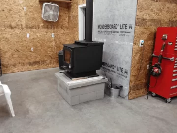

I own an NC30 and run it really hard to intermittently heat 1800 SF of shop space with a 14' ceiling. You can't really use the SF ratings of a stove since so many assumptions go into that number such as ceiling height, insulation level, outside temperature, etc. Instead you can only really go by stove output which is directly related to stove size. The NC30 is about the biggest stove you can buy. That's why I bought it plus it is an exceptionally good value at the low price of 600-800$ and well made.
If your question is whether the NC30 is big enough, well, you can't go much bigger and I wouldn't want a smaller stove either.

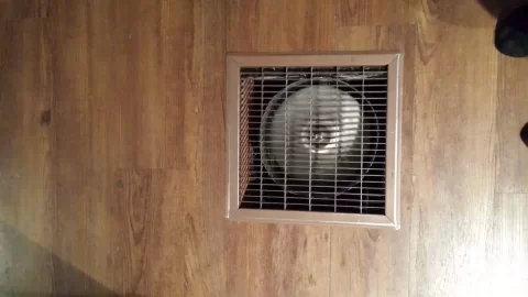

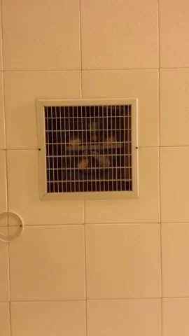

I have a 3000sq/ft 2 story house and have no issues keeping the house from 20c - 25c with the 30. Air circulation is key. My stove is in the basement and works well from there. Old house but fairly new windows.
This fan installed in the floor is the cat's meow when creating circulation, I have it blowing up, the flow of cool air coming down the stairs is tremendous. Some say it should be blowing down, but it was installed when I bought the house and works great this way. When I have to replace it I will try switching flow direction for poops and giggles....
[Hearth.com] Englander 30-nch [Hearth.com] Englander 30-nch
View attachment 192547 View attachment 192548
How noisy is the fan? It looks like a duct fan. I was thinking of adding one in a vent like you showed then have a wall mounted thermostat to control the flow for each bedroom and have a vent that allows cool air to return back down the stairs. Maybe I'm over thinking it but remodeling allows me to add stuff where I want it the first time and not have to screw with retro-fitting later and something coming out looking like crap.
It is not bad, although I only have to run it at 1/4 speed. It will get noisy if you crank it way up, but it's not necessary. Yes it is a simple duct fan.

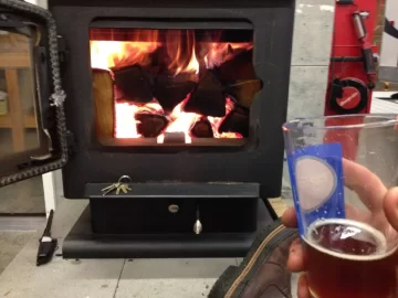

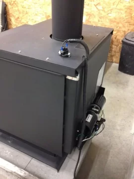

I modified the stove by adding a much larger blower, thermostatic blower control, and a convection deck to really strip the heat.
OK so I'll try her stock then look into the holes of I'm blowing thru wood. You made the other stuff i take it? How much air gap did you leave?

I think it's 1.5". If you'd like to make one I can take measurements for you.
That would be great when you get a chance no hurry though.
It's 1.5" 0.125" thick square stock. The convection deck on this stove totally changed it into a heating machine. Right now the stove and entire shop are 40 degrees. I plan to heat everything up to 70 with 4-5 reloads within a 12 hour stretch and keep the nc30 at 700+ the whole time!

Would you be able to take a picture from the front? Did you attach it to the stove in some way? Also where did you source the thermostat from and is it 110v or did you just hook it up in place of the blower switch or in series with the switch?
