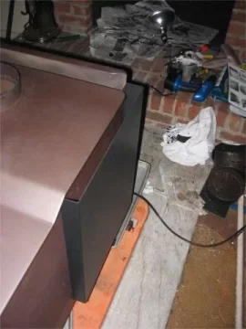

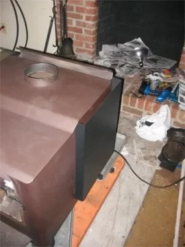

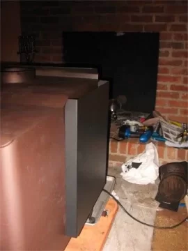

I am the proud new owner of an Englander 30. I am looking at getting the side heat shields that fit on this stove, and I was wondering if any of you 30 owners out there have them on your stove? I was curious if they go the full length of the stove or just part way? I couldn't tell by the pic on the website, and I couldn't get through on the service line. Thanks

I am pretty sure that in the manual the heat shields actually increase the distance needed from combustibles by one inch. Weird huh? I have seen one set up and they ran from the top to the bottom. Is that what you were asking?
The heat shields cover the back half of the sides of the firebox. From the front of the top step top to the back of the stove.

If it doesn't cover the whole side does that mean your distances to combustibles is different where it the shield stops? Or is there that much heat difference between the back of the stove and the front? Doesn't make much sense to me. Thanks for the pics.
I've got my 30 in a corner install. The clearances weren't hard to meat without without the heat shields.
I don't believe the heat shields change your hearth pad size requirements.
