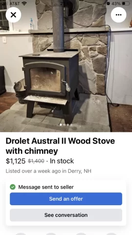

For big value heater at the best price, I would get the 32-NC. In the SBI line it is more comparable to the Drolet Austral/Legend/Myriad III..
Reactions: Highbeam
[Hearth.com] Englander 32 NC or Drolet HT 3000?
Facebook marketplace, Derry NH
