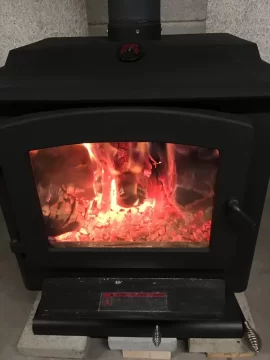

Still mixed reviews. Our local Lowes sells this stove as Model #50-SHW06L for $999. Has 8 fairly recent reviews right now . 4 Good , 3 Horrible and 1 guy reported fumes burning off the paint so his fault. So i guess it still depends if you get the warped door or not. Iv been using mine again as englander sent me a new door glass kit. Mine shattered while the stove was burning .Same as in one of those bad reviews.

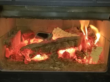

Same Stove. Not quite sure what they did to it but changed the model number recently. That at least temporarily got rid of the previous bad reviews. All i can say is its a great stove with a problematic front door that tends to be bowed out in the center letting excess air in and overheating the stove. Iv had 2 of them ,both the same. I manage mine by not completely filling the stove with wood so ,no long burns but great fire view.
