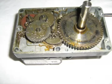

I haven’t seen that gear failures as a reported problem, usually the motor shaft seizes. Out of curiosity I opened an original Merkle-Korff motor and all gears were metal except the gear that engages the motor pinion is phenolic. I found the same thing on an ECM motor with the rest being steel gears. Check heat treat pattern on the ECM motor output gear.
  • [Hearth.com] Englander auger junk. Gears not motor
Looks like induction hardening. Nice photo, BTW.
