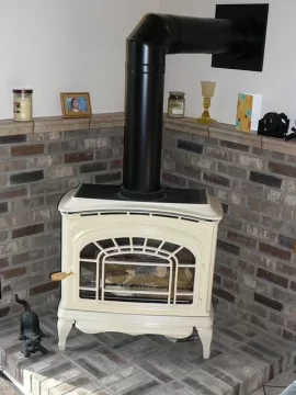

With all this info and you being a new member (this is your 1st post)... Why dont you start a thread and introduce yourself with pics??
We love pics....
Will do !! That will be a project for tomorrow. I have before pictures and can take some after pictures in the morning.
EDIT: Here is a before picture.

The 7" hole saw was a joke!!
I have a resip saw. I'm going thru drywall then the siding then vinyl siding. I think I know where the electrical is at about 13" above the floor
I hope! I've located the studs 16 on center and the exhaust will go in between. I built a tiled hearth to set the stove on so it will be above the electrical. I also purchased a 3 foot section of pipe for the outside, I figured the less joints was a good thing!!! The adapter, 1' section of pipe and then the T will leave the chimney 6" from the house at the T, then the 3' section, the 90 another 1' then the cap should get it about 8 feet above the ground. Is it ok the lean it back to the house to attach the bracket?
