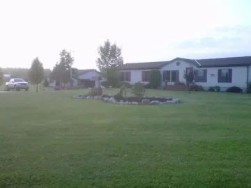

I just purchased a new Englander Evolution 25-EP that I will be installing this summer. I will update with pictures as I progress with the install. I will be doing most of it myself.
First.. I'm still working to find a good location that will work well with my house and of course the venting.
The plan for now....not real excited about looking at a pipe sticking out the front of my house but I don't see any other option??
The stove is going in a corner and will be vented horizontally w/ about a 3-4’ rise. I have put some pictures here to help. The vent will be going through the wall to the left, hopefully about 6-8†from the corner.
The pipe will come out about 3’ from a window and sort of under my porch a little. I know it says in the manual that I need to be 4’ from a window but I have also read that if I have a OAK that is reduced to 18â€. Is that correct?
My plan is to use Selkirk Direct-Temp pipe that has the vent made into the outer pipe wall.
Suggestion welcome...
Thanks..

make sure the vent is at least 24" below the vinyl soffit.
i tried to give you a ring , message on answering machine, dropped you an e mail as well. the 24 inches to the soffit is a great point as well, sorry i missed that in my e mail. gimme a yell tomorrow if ya can during the day , cell number is in the e mail i sent ya

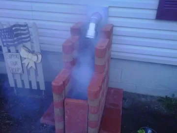

Very Nice Looking stove. I love a Good Looking Englander. Having Mike to help you along is gonna be a tremendous amount of help. That EP is supposed to be a Killer stove.
The vent on the front will grow on you and the high pipe inside looks classy (I think so).. I don't have any recent photos. My vent comes directly out the front of my home (Direct vent). I have a pic from a while back. (Pre-OAK). I was really nervous about "Sparks" (Funny Thread about another Forum member on that) coming out the pipe. I did this 3 yrs ago. I have decided to leave the landscaping edgers. Have since mortared them together and made it permanent, and also took the front 12x6 paver down (Looked terrible). But like I said. I had not found this Forum yet and didn't know better. Abided by all clearance to combustibles. One pic is up-close, the other is pretty far back and the exhaust is kinda right behind the tree (Look above the small tree in the Island) in the pic. House is couple hundred feet off the road. So unless you knew what a PL Vent looked like. Most think its a Dryer vent when they come over.

Yes, Mike was helpful and I'm sure I'll be calling him again. I don't think a horizontal termination on the front of the house is going to work. I can't get the 4' needed from a window. Mike had some good suggestions and got my wheels turning on some others. I need to climb in the attic and measure some more....
My house is 2400 sq ft, so I think the stove should do quite well. Its not as cold here as many of your northerners have to contend with either. Last year I spend over 2k in propane and my elec bill was running 400 easy a month. This was my first winter in this house, so that was kind of a shock. I will also enjoy the fire burning in the evenings.
I have been looking around for a good deal on 3 tons of pellets and have only come up with Big Heat and O'Malleys. Both have a plant about 30 minutes from me. I didn't check with the local southern states, probably should do that.
From reading the o'malleys don't seem too bad. They want $200/ton. The Big Heats are $197/ton. But i haven't heard any good things about big heats.
I apologize, I didnt mean you should go with a direct vent. I was just saying that a vent, coming out the front of your home (No matter the hieght), does not look as bad as some think. If done correctly, most visitors will not know what it is. We too spent a lot in LP ($4,000 a yr). I have never heard of Big Heats before. So I have no comment there. I have heard of "Easy Heats". A new plant that just came on-line here in Ohio. Being from Virginia, you could probably get some Lignetics. They are a Good pellet.

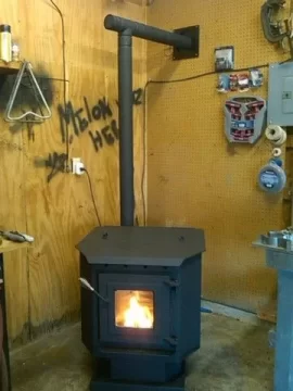

Anyways, I apologize if you thought I meant direct vent. Englander states to put at least a 3 ft rise in the Vent. I did 5 ft rise in my shop. Its not the prettiest, but she heats like a Beast. Nothing like a 15 yr old stove. Excuse the Spray Paint on the walls. Messy...

I did some more measuring this weekend and found a way to get the pipe out the roof. It will cost a little more but will make for a cleaner look in my situation. I found a good deal on the Selkirk direct temp stuff. Looks nice and I don't need to run a separate OAK.
I'll post some pics as I make progress.
smwilliamson said:
Prevailing wind??? I do not like that installation location at all.
Yea, I don't like it either. It wont meet code anyhow. I am doing a vertical termination.
