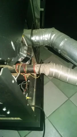

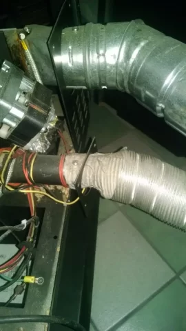

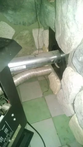

Can you post a pic of the entire vent setup, inside and outside the house?
Don't forget to check the inlet of the OAK and make sure it isn't clogged with anything.
