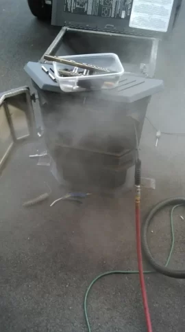

I know not everyone can do this but this is how I clean mine with the air compressor outside. IMO the best way to clean the stove if you have the means to do it this way.
