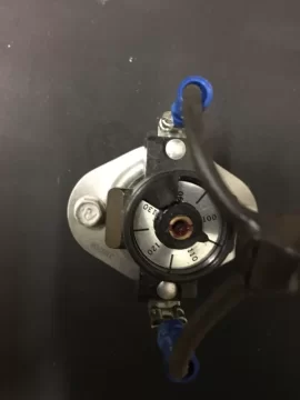

I use the slightly more expensive adjustable snap disc. Use a screwdriver to turn it up or down, there is even a label with temperature increments.

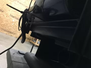

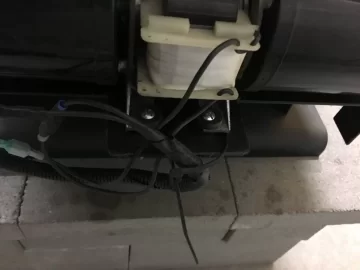

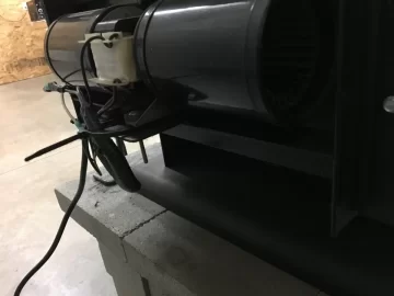

Please take a couple close up pictures of how the blower mounts to the angle irons that are connected to the back of the stove. Both sides please
It is worth the extra money to buy the adjustable snap disc.
I used my IR gun for a few readings on where I wanted to mount my disc, meanwhile with the STT around 700°F. I think it's a 215-160.

Let’s try these. The horizontal length of angle has a flat spot on top. I welded a square of plate steel to that angle iron to create a platform with 4 holes in it to attach the blower.

Thank you for the additional photos. I see you have angle iron on each side and angle iron on the bottom. There's a plate welded in the middle of the bottom angle iron to attach the blower. Looks like you have some rubber insulators on there too? It doesn't appear that the upper portion of the blower is attached to any angle iron , just the bottom attached to the plate. Is that correct?
The temperature range on the snap disc seems low. If it goes on automatically at 130 degrees, wouldn't it be on all of the time?
Looks like he has it set for 105°F. It all depends on where it is mounted. Mine is mounted a little higher than his and I think is set for 185°F.

You’re correct. The rubber grommets came with the blower and it is only attached on the bottom.

The snap disc is located on top of the deck. You don’t want it on the stove, it’s too hot there and electronic devices are happier at cool temperatures.
The goal is for the fan to run anytime that additional heat can be stripped from the stove without overcooling the stove enough to cause dirty burning. In practice, in my application, this stove is either cold or very hot. The setup works perfectly and the low temp range adjustable thermostat was selected based on testing with a laser thermometer at the desired snap disc location.
The convection deck is like a huge heat shield that actually blocks a lot of radiant heat. It stays pretty cool on top, especially with the fan running.
