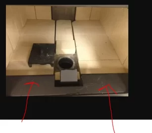

Are you referring to this area?

On my NC30 that bottom plate has puckered a slight bit but is held down by the welds. I have seen some crack and break the welds, even completely removed from the stove but mine is hanging it there.
More importantly, I have melted the similarly thin air deflector plate on top of the door opening that directs the airwash. It sagged in the middle while I was sitting there warming up the stove. It was not an overfire but a full throttle warm up that must have concentrated too much heat on that one spot of thin metal. It sagged, I bent it back into place somewhat and it hasn't moved since. No apparent effect on airwash function or stove performance.
No other part of the NC30 has melted on me and I use my NC30 for maximum safe output so I do believe that the rest of it is adequately designed for normal temperatures.

It sounds as if a bit of bowing upwards is normal...?
I looked at some pictures and on my lower plate, the puckering is close to the loading door with one pucker on each side of the doghouse. No cracks and it doesn't seem to move. I'm not even sure what the plate is for.

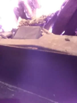

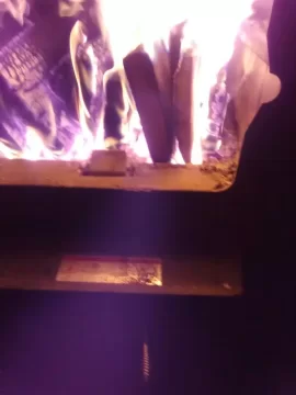

I noticed this morning that the plate warping increases with a hot fire, and reduces when the fire cools down.

I remember in the first couple of years that the bottom plate would pucker with heat and then settle back down when cold. There’s probably a metallurgical reason for it but eventually the plate stiffened up and stays put with just a slight pucker on mine.

I finally got to speak with someone at England Stove Works about my warped plate. They said that the photos indicated that it was a bad welding job. Looking at the plate closely, it only has two spot-welds, one on each side of the plate. England Stove Works offered to find a local welder and have him come out and re-weld the plate for us.
We ended up declining their offer, and (with their permission-not to void my warranty) we did the welding ourselves. However, it was more of a chore than I thought. We had to get a torch and heat the plate a cherry red color in order to be able to pound it down flat. Once it was flat once again, we tacked the plate down with a nice bead.
I appreciate England Stove Works trying to make this right, but am disappointed that the stove left their shop without a proper weld job in the first place.
