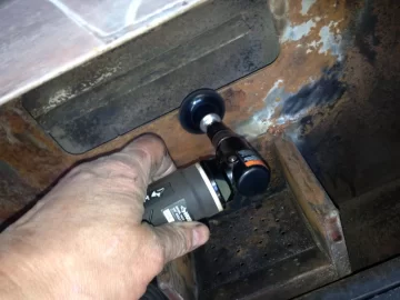

Here is a procedure I am testing on an Englander 25-PDVC pellet stove firebox for a little Rust Relief and smoothing out the ruff areas for better air flow and stove performance!
The importance of the die grinder is that it grinds alot of the rust and carbon up so the Acetone wipes it away!

Pic 3 - Grind ruff surfaces smooth for better air flow and performance with pnuematic die grinder
Pic 4 - Grinding area above fire box, this also removes much more rust and carbon buildup

I believe it was in a damp basement not being used for quite a while. The wire wheel just would not cut the mustard here. I did use the wire wheel to knock down the rust on the initial pass, but then I had to pull out the pneumatic die grinder to really smooth it out and grind the rust up. Then the Acetone wiped it away and it was good for painting.
