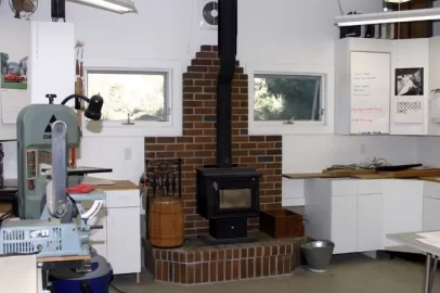

That's the stove I have in my workshop. I'm sure it's no Englander, but it's a pretty dang good little stove, and it gets the job done for me. Of course, I'm not heating 1000SF with it, nor do I try for anything like an overnight burn...but one of these days when my wife boots me outta the house, I might have to. The price sure sounds right. Give it some thought. Rick
What is that area under the stove door, is it another door for ash clean out or what?
You can get a blower for the Century...in fact, I've seen 'em on eBay. Part number's in the owner's manual (what there is of it). You do need to allow ~6" clearance behind, as it mounts directly to the rear heat shield, but in most installations that shouldn't be a problem. I don't use one on my shop stove, the stove/ceiling fan combo does the job nicely. In a more complex space configuration, the blower kit might help a lot to move/diffuse the warm air. (thanks, C'mon, I really like it too). Rick
Captain said:
...What is that area under the stove door, is it another door for ash clean out or what?
The stove sits on a pedestal, not four legs. Integral with the construction of the pedestal is a removable ash drawer. Inside the firebox, one of the firebricks in the floor has a little steel loop cast into it, and this brick can be lifted up and the ashes pushed/swept into the pedestal below to cool. Then the drawer can be pulled out, emptied and replaced. I use it once in a while that way, but usually I just shovel out the ashes into an ash bucket the old fashioned way. BTW, the airwash flow in this little stove actually seems to be more effective at keeping the glass nice and clean better than that in my Lopi Liberty in the house, but that may be related also to the firebox size and the fact that we put a lot more burning hours on the Lopi than the Century. Rick
