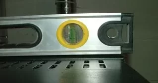

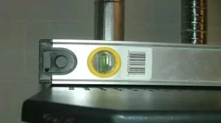

Doubled checked level, since I just place the stove on the concrete floor... assume to be level... from front to back, not quite an 1/8" off, side to side, pretty much dead on. I'm not sure but I don't think 1/16" - 1/8" would make a major problem.

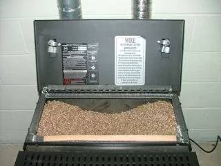

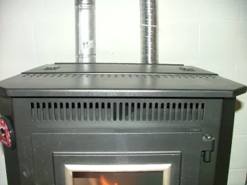

After my original post I did a little closer examination. It seems that my hopper lid is slightly bowed between the latches. I'm going to guess that because it was a display unit and people fooling with it could have latched and forced it closed with something under the lid causing it to bow? There for not making a tight seal in that area. Also some frays where is seems the latches caught.
Attached is photos, although difficult to see the bow.

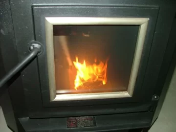

Here is what I found, I had a better flame - higher, and a higher temp about 10* -20*. As far as carbon build up? not sure yet because it has only been running about 12 hrs. But still burning a bit rich, although maybe changing the setting might help, I just think it is the nature of the beast on low.
Also attached is a photo of the flame and a photo of fire box after about 12 hrs or so.
OK back to the drawing board ... have to make the photos smaller.... so I will post them in a bit.
  • [Hearth.com] Englander/Summers Heat -  25-PDVC / 55-SHP10... What Is or Is This Normal or Typical and my set-up..

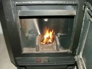

OK... photo showing what I guess is Typical of being on Low....
(also need to get photos smaller)

Additional photos of lid, fire box /pot after 12 hrs on low with extra seal in place and hopper with the extra foam seal placed on top

I don't think level is going to change anything. My stove is just sitting on the floor and never checked for level.
Good test with sealing the top. Maybe if the top is bent Englander could send you a new one. Using your level as a straight edge. you can check under the front of the lid to see if it is bowed. You may be able to bend it back yourself if you were careful checking it with your straight edge.

I just noticed the same hopper bow yeasterday. It does not appear to cause the lid not to seal but I'll check it closer. I have only been running the stove X1 week but I did not notice the bow before.
staplebox
I believe that a slight bow is normal because the latches are on the ends. However with my stove I think it might have been a bit mishandled at the store since it was a floor model.
