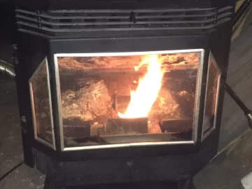

Yesterday I just picked up a 25-EP to tinker with. Puts out tremendous heat for it's size and the only top feeder with a Direct Drive auger! That means No Auger Bearing to wear or get dirty!
See pic
