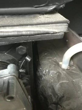

Doylee this covers the whole process for your auger removal and install
Here
  • [Hearth.com] Englander ticking noise
Square headed bolts? Grease zerks that are unreachable without disassembley.. great stuff here lol.. welp im just waiting on a 90 degree coupler for my grease gun to come in mail
Lol yeah i rotated my bearing blocks so i could get to them easyer.
