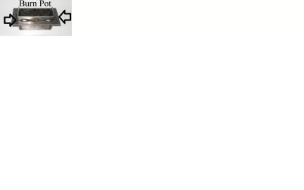

SC0872, Early on I felt as if the stove wasn't quite burning to it's fullest potential. something I notice on my burn pot and this may be the case with yours-The plate that surrounds the burn pot isn't completed weld. I'm sure this is intentional however if you look at the picture I attached, and the arrow on the left side, you will see the space I'm talking about. I sealed the space between the burn pot and plate with DAP high heat mortar. After sealing I replaced the burn pot and started out with a small fire for about an hour. If you look at the picture again you will see an arrow on the right side pointing to burn pot holder plate. While the stove was in use I noticed on this side there were never any burnt ashes. I had an air leak underneath this plate (probably got distorted during welding). Next day during cleaning, I took and leveled this side and no more air loss. What a difference! Maybe you are having the same problem I had, who knows-good luck

Oh, that. I hate to disagree with the poster, Matt F, but I seriously doubt sealing that vertical piece made any difference. That piece around the top is just to keep pellets from jumping over the burnpot.....the burn air comes from below the pot, not above the flat plate that piece is welded to.....that's why they just used small "tack" welds.
Any improvement he got was from leveling the plate, not sealing that seam.
I don't think the poster mentioned leveling the plate at this point? I agree, sealing the vertical space in the corners of the pot would not improve anything
The burnpot has an air gap between the pot and horizontal surround plate. After sealing this gap I noticed an improvement in burn quality and length in burn time.
