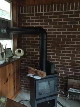

Hey all....I just got this stove installed last night and am like a kid in a candy store waiting for winter. But I think I screwed up..... I couldn't wait, and lit a small break in fire last night. It smoked from the fresh air outlet. I was under the impression that it wasn't necessary to hook up unless in a mobile or man'd home. Fire went out quickly and I felt like a dumb*&... So is anyone using this guy without the outside air hook up? Did it just smoke a bit because of a cold chimney?
Chimney is also on the short side. I didn't want to go through the roof so I went through a wall. It's at the end of a ranch house with wide eaves, 3'. So currently it is 3' high in the house, then a 6' horizontal run through the wall and past the eave, then 7' in the air. Tech support says it should be sufficient. Anyone have experience with a short stack on the 17VL?

Hard to get a good draft when it is still this warm out, the smoke will backfill and find anyway out it can, and the OAK inlet is the perfect place. Wait for colder weather and try again, of course that might not be till December in Atlanta.
Ha! Good point and info....again....I don't know what the hell I'm doing!
Could try and use a large propane fired torch to help start a draft.
I have burned mine for three winters without an OAK hooked up and no problems. My chimney is right at the 15" minimum and straight out through the roof. With a short chimney and most likely higher temperatures I'd say you just experience an extremely bad to non-existent draft. A 10" tall chimney with two 90's and 6' horizontal run sure doesn't sound sufficient honestly IMO. Cooler temps and or a taller chimney will probably be all you need. Enjoy that stove. It's a great little heater!
Yeah, I'm not thrilled about the 6' run but I didn't really have many options....I couldn't go through the roof for a number of reasons. If I were going to add height I'd be worried about the weight of the chimney...that wall band isn't a heavyweight holding guy. Since I'm not against a wall the chimney is suspended out 3'. Any advice on how to secure it. And if I were to add height.....would 2' or 3' be enough to help? I realize that's a hard one to answer....

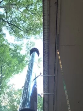

Any additional height would help. Is it possible for you to post picks of the outside and how it's supported?

Thinking about making a bracket that goes from the bottom of the tee up to the fascia board.

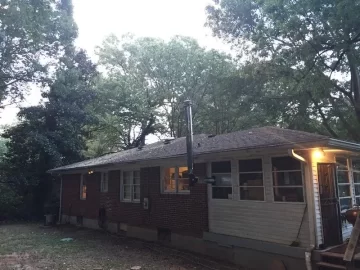

You can see my 10' mark on the roof. The chimney is 30" higher.

A proper through the roof install would be lightyears better than what you have now. I'd concentrate on making that happen if at all possible. It would support the weight of the chimney, be a straighter run with better draft, and eliminate that through the window situation. With a 17 your going to be doing cold starts more often, most likely. Improving your chimney and draft will help a lot in that regard.

Can I ask why you cant go strait through the roof? Looks like this is a good candidate for a cathedral ceiling support box (there a little longer than a regular ceiling support box) then 3 lengths of class a pipe with roof support bracket. Its actually a very simple install, plus it will be a little stronger and you will still maintain you 10-3-2 chimney rules.
You just need the duravent cathedral ceiling kit.
I'm glad I found you guys....looking at the roof now and succumbing. I have the sure temp by Selkirk. I don't believe it will mate with the dura vent but I was looking at the cathedral box. Looks like another run of 36" pipe will be all I need and the box and flashing. Couple hundred bucks for safety and proper operation. Worth it.
