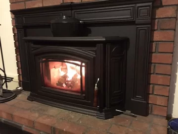

Here's some pics of my Boston. Everyone always takes pictures straight on, so here's a side look. [Hearth.com] Enviro Boston/Kodiak questions before purchase

Here's some pics of my Boston. Everyone always takes pictures straight on, so here's a side look. View attachment 165053

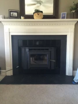

I would go with the Boston. But, I'm a bit biased. I burn 24/7 and use a little over 3 cords. (A bit more last year for that never ending winter) We had to recess ours in the opening to make the front clearance and add a top piece to close in the large opening. ( The lighting in this picture makes the insert look more gray than the black that it really is)
