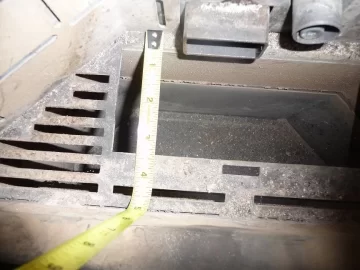

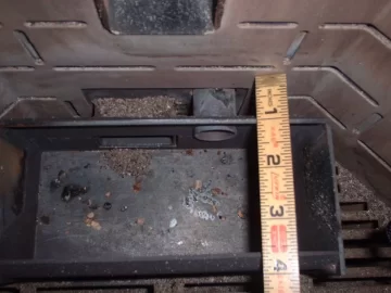

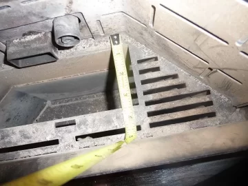

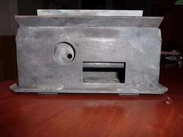

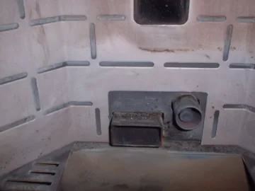

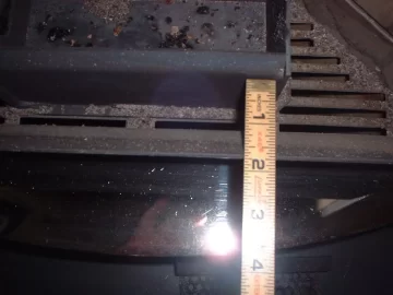

I think I found my 1/8" gap... The bottom grate is rotated 1/8" clockwise making the igniter 1/8" further away. You can actually see the outline of my burnpot in the ash. It is further away on the right side. 3 1/2" from the back on the right and 3 3/8" from the back on the left... Does anyone know if this grate can be twisted back?

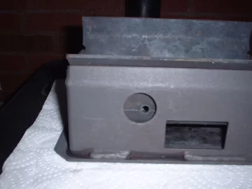

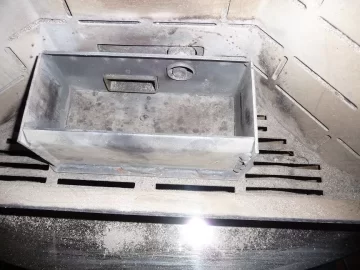

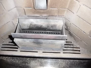

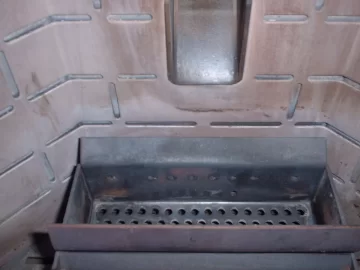

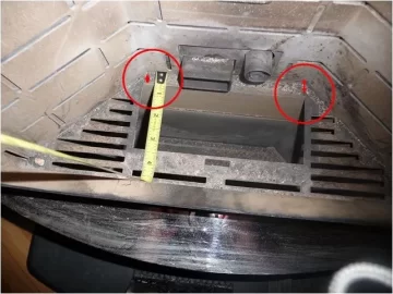

I think your looking at it the wrong way.Your measuring from the fake brick and that might not be sitting tite.The brick in mine has a slight angle in it.It's tighter to the back on the left side than the right by a hair.I looked at gap between the liner and the tube and mine has about a 1/32 gap btween them.of course that's a eyeball guess.Here's som pics of the burn pot in relation to the firebox

Your burn pot is further out than mine - which doesn't make any sense. On your picture on the right you show 1 3/4" from burn pot to outside frame. I have 1 7/8" from burn pot to outside frame. Your tube is defenitly closer. Mine is 1/8" Plus from tube to liner. I appreciate all your help today. I'm not sure what to do... There is clearly something wrong on my stove....
One thing i notice is your the air outlet on your's protrudes further into the burn pot than mine.I don't know if that indicates anything or not.you can try telling your dealer your going to start bad mouthing his buisness around the area.That might get a rise out of him
