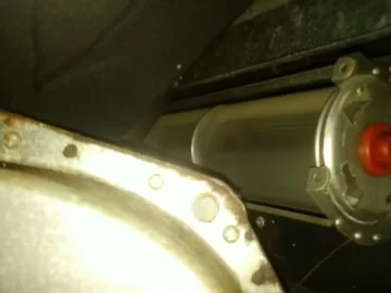

Just picked it up toady, gave it a good cleaning, fired it up in the garage and when the convection/room blower turned on finally it does not blow out alot of air, just a slight breeze, is that normal?, i took the side panel off and noticed the blower spinning, it is a long blower kinda like what BMW uses, is it right to have the squirrel cage wide open?, is there some kind of cover missing?, it does not blow out the heat like my Whitfield!
Here's a pic with it blowing, also I tested the voltage to blower and it's 113v ac [Hearth.com] Enviro Empress convection blower seems low?

Thanks for the reply, i had it running on high and it just seems not much heat blow's out, nothing like my Whitfield which blows a good wind, this just a slight breeze, feel it on your face, the insert uses the enclosed fan like my whit.
I cant see it heating up a room with that slow of air blowing out, hell a hair dryer blow's more

That red "plug" on the end of the motor....is that removable? Can it be given a few drops of oil there? On the motor end?
Usually when a motor runs better at low speed AFTER starting it on high, means the bearings are somewhat dry.
