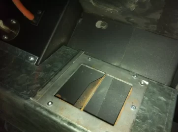

Thanks to all!! The stove is back up and running. Fingers are crossed. I pulled the convection motor off and cleaned it well. It would appear that the dust bunnies decided to take up residence in the fan blades.
I've attached a pic.
Thanks again
