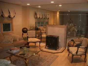

I love my Empress, much quieter than others that I have listened to and easy to maintain.
As for heat, I have ours in the living room of a 1500 foot bi-level and
use ceiling fans to move the heat around and it does a very adaquate job even in
the bedroom farthest away from the stove.
The ash pan is under the firebox and is a drawer which is recessed away from the
front of the stove by about 4 inches and does not take away from the
beauty of the unit and makes it easy to empty when needed..
All in all i am quite happy with the empress and the installation.
Jay

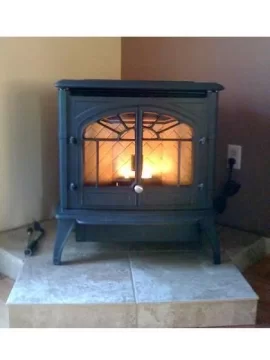

I also have the empress, and love it. It heats well and here is a pic of my stove. I think it looks great. I was swayed to go with this because of the wife. She liked the look of this one the most.
